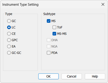

To switch an Instrument to a mode where it can collect and evaluate MS-MS data, select the LC / MS / MS-MS or GC / MS / MS-MS option from the Instrument Type Setting dialog.
Instrument Type Setting dialog is invoked by clicking on the button in the System Configuration dialog.
Options that are technically possible and have been purchased are enabled by default. Otherwise they are automatically disabled.
