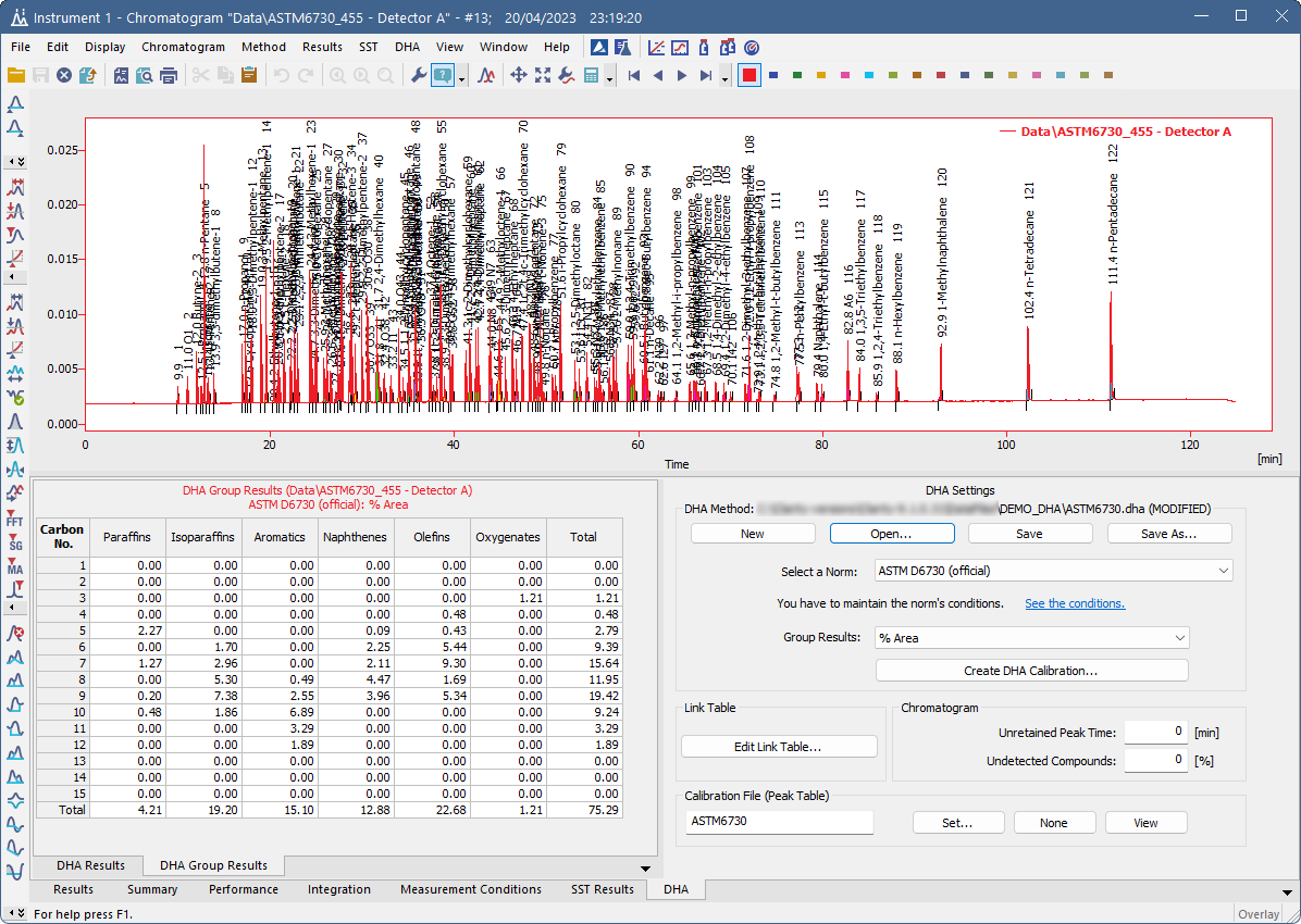

In the DHA Group Results tab, you can find results calculated according to hydrocarbon types. The results are automatically recalculated each time you open or change the chromatogram or select different norm or modify its parameters.
Chromatogram window - DHA Group Results
DHA Group Result Table
This table displays the results in a special pivot table. The units of the results in the table depend on the units you have selected in the DHA Settings - Norm - Group Results combo-box. You can see the summary results per carbon number or per a group of paraffins. You may see the following warnings:
