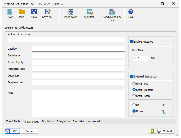

Several terms used in chromatography were substituted by the equivalent terms used in the capillary electrophoresis. Moreover, some of the information fields on the Method Setup - Measurement and Chromatogram - Measurement Conditions - Instrument tabs were renamed to better match the CE terminology.
Substituted CE terms
| Default mode | CE mode |
| Chromatogram | Electropherogram |
| Retention time (RT) | Migration Time (MT) |
Renamed existing informational fields:
| Column | Capillary |
| Mobile Phase | Electrolyte |
| Flow Rate | Power supply |
| Pressure | Injection Mode |
